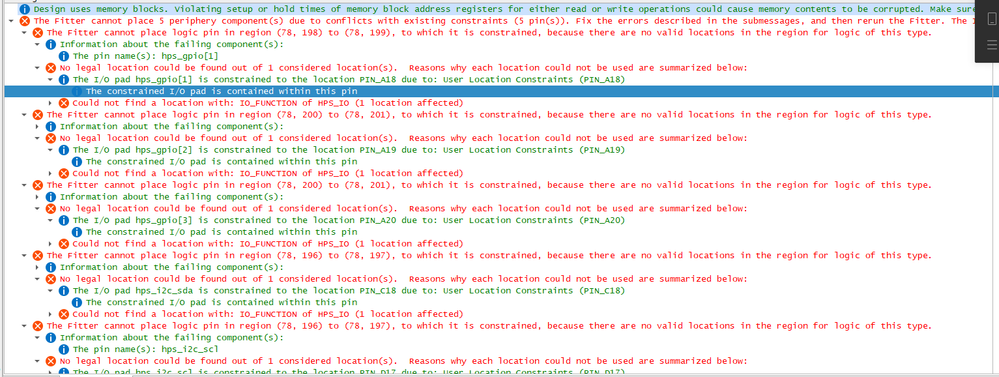

I set the HPS_IO in the A10 (10AS066H3F34I2LG) , run and get the error about this :
Are there any wrong set in the HPS ?

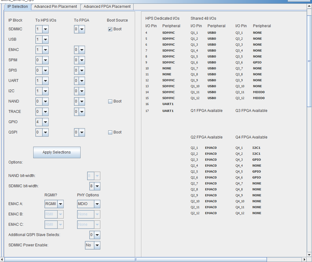

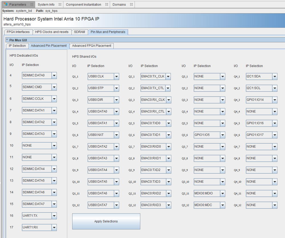

    I noticed that the gpio1 pins is not grouped under the same quadrant.
    Can you group them in the same quadrant Q3.
