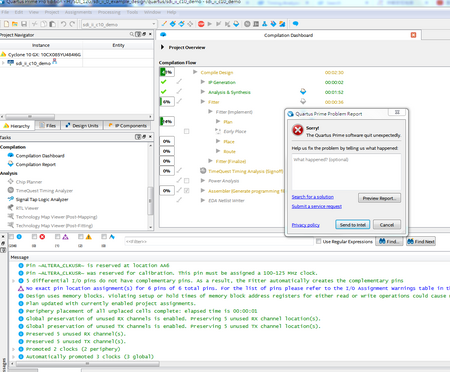

Hi, I am running the generated demo in 12G SDI on Cyclone 10 GX at Q17.1.1. But the fitter always report error message. Please let me know how to get through this. Thank you! Regards, Joh...
JLee25
Contributor
7 years agoAfter switch to Q 18.0, this problem was gone...
