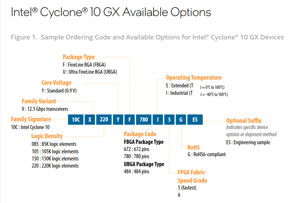

Need your expertise & advice regarding part no. 10CX085YF672E6GGA what is suffix GA meaning?
any functional issue compare to 10CX085YF672E6G,

I do see that the two letter part you're referring to is called 'Optional Suffix', but there are no further details about it in the datasheet that simply lists all optional suffix options for more clarity. But imo it shouldn't affect its functionality

The optional suffix is for the specific customer, so the one that have this device is expected to know the meaning behind this special suffix.
Kindly confirm where did you get this specific device?
