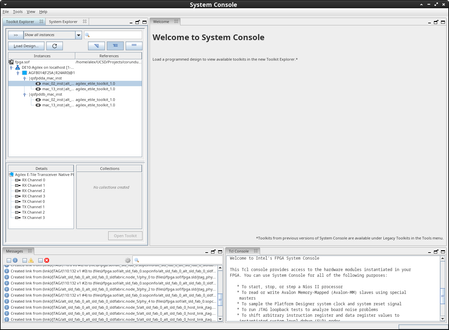

4 years ago100G E-Tile system console connection problem
I am running in to an issue with debugging the E-Tile in 100G mode via the system console. Even though I have the "Enable JTAG to Avalon Master Bridge" option selected in the parameter editor, I am ...

4 years agoI'm not sure what the relevance is of AN647, that's for a gigabit interface presumably using a soft MAC, and I'm trying to bring up a 100G interface with the E-tile hard MAC.
Anyway, checking with the E-tile example design is a good idea, I'll try that next week and report back if I'm seeing the same issue.
