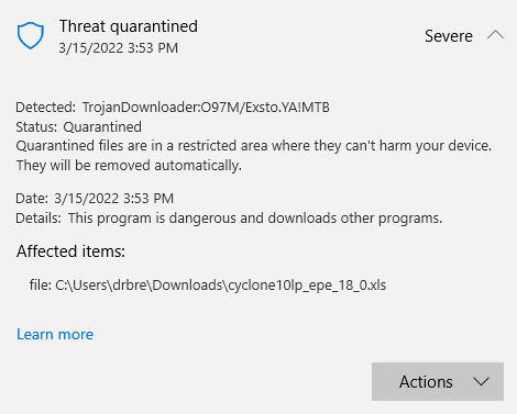

Windows 10 Security Reports Trojan in cyclone10lp_epe_18_0.xls
I downloaded the Office 365 version of the EPE spreadsheet for Cyclone 10LP from the link below and Windows Security (Version 10.0.19044 Build 19044)
reports the trojan below. Is this file really infected or do I have to do something to work around this?
https://www.intel.com/content/dam/altera-www/global/en_US/others/support/devices/estimator/c10-lp-estimator/cyclone10lp_2021/cyclone10lp_epe_18_0.xls

  • Farabi_Altera's avatar
    Farabi_Altera
    Hello Dr Brent,
    Intel has reviewed the content of the cyclone10lp_epe.xls and cyclone10lp_epe_18.0.xls excel files and found no trojan viruses in these files. Antivirus program indications of a virus in the Intel FPGA Early Power Estimator tools that are downloaded from Early Power Estimators (EPE) and Power Analyzer (intel.com) are false positives that are likely due to the use of macros and DLLs that are embedded in the Excel files that have functionality that is similar to real viruses.
    Intel recommends updated your antivirus software to the latest definitions which may resolve the issue.
    regards,
    Farabi
