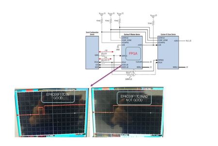

5 years agoWhy doesn't 'EP4CE6F17C8NAD' wake up
Hi
Thank you for your reply.
The picture above is the waveform of the nCSO pin during initial startup.
The left is GOOD(EP4CE6F17C8N), but right (EP4CE6F17C8NAD) is NOT GOOD.
all con...
JohnT_Altera
5 years agoHi,
May I know what do you mean by "not good"? Have you monitor the "nStatus" signal with the "nCSO" signal? Have you confirm if the MSEL setting is correct?
