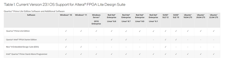

- LChow3
In this link
It seems that Windows 11 is not compatible with the Questa*-Intel® FPGA Starter Edition.
Any suggestion on which version of ModelSim I can use?
- KianHinT_altera
Please use Quartus lite 23.1 as it is compatible with window 11. Previous Quartus version will have some issues like open/saving (due to windows 11 MS one drive, need disable sync desktop ) or some other issues that requires some workaround fixes in order just to run as it was developed based on Windows 10 . Thus it is advisable to use 23.1 on Windows 11.
