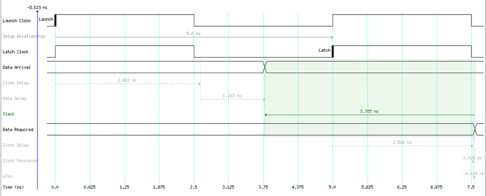

The is the information I get on setup slack in TimeQuest.
As you can see, micro setup time [uTsu], is added to the data required path, making the setup slack larger, not smaller.
Isn't this in contradiction to what is mentioned above.

Here is the included Waveform. In the waveform it is written -0.018ns. But as you can see from the small arrow it is added to data required time.

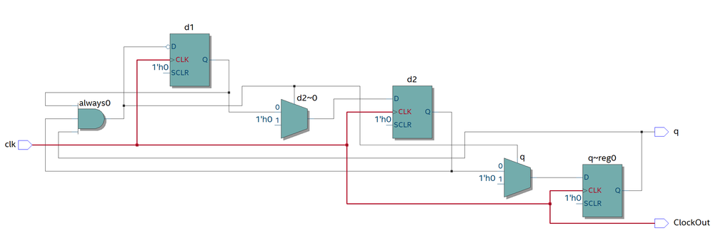

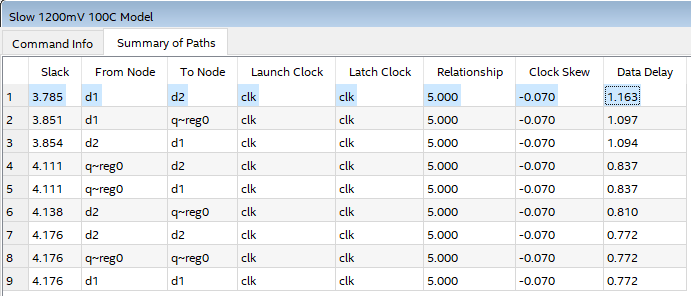

Below follows verilog code, RTL view and Summary of Paths.
The design is compiled for the Cyclone10LP 10CL025YU256I7G.
It is path#1 (d1->d2) that is given in the waveform above and the Setup Slack details.

uTsu is the silicon-based setup timing requirement. It is the latest time before the clock edge that the data must arrive. Look in the Waveform tab to see how it is used to designate the data required time. The timing report you've posted shows the latest data must arrive, taking uTsu into account, and based on the clock edge arriving at the destination register. Normally, I see this value as negative since it should be subtracted from when the clock arrives to calculate the required time. I'm not sure why it's positive in the screenshot. Can you post the waveform tab?
