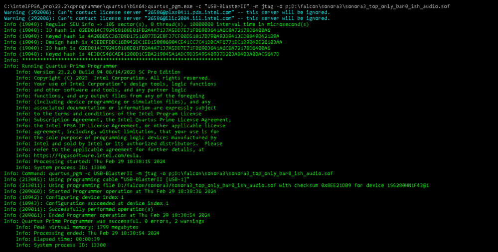

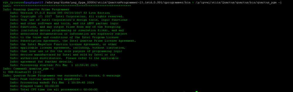

[USB-Blaster2] unable to flash image due to Error (210001)
I have problem to flash .sof image through linux enviroment It will print out error (210001) not valid sof file
Here is my result :
linux os : SUSE Linux Enterprise Server 12 SP5
At same time i did check usb-blaster2 connection so far no issue able to detect in my linux enviroment.
but when switch to window enviroment I able to flash .sof image with no problem
Here is result :
Apprieciete if can provide me some guidance thanks.

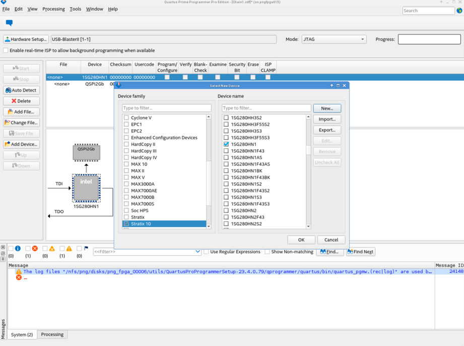

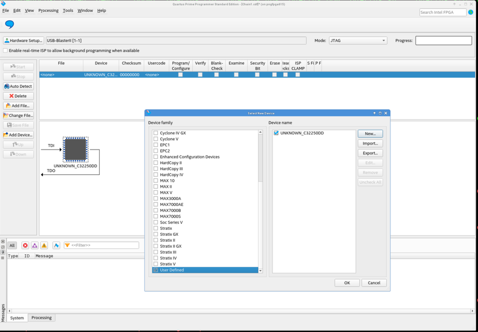

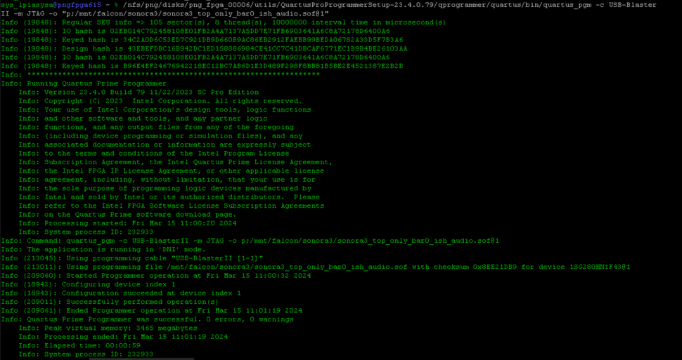

    • SeongLim's avatar
      SeongLim
      Hi Fakhrul,
      The issue has been resolved. It because I am using the Quartus prime programmer standard version which is incompatible for stratix10 family. Here is the problem I found when I run GUI mode.
      Version: QuartusProgrammerSetup-23.1std.0.991-linux
      Upon installing Quartus Prime Programmer Pro version, the issue was resolved. Now, it can automatically detect the Stratix 10 device family when I run it in GUI mode.
      Result from Linux CMD:
      Btw. I appreciate your assistance with this issue thanks.
      Seong Lim
