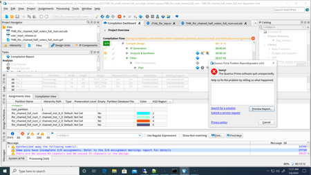

I am opening the design partition window (as you can see in the screen shot) and then declaring the ASD region by putting in an assigned number in the ASD region column. I tried it with 2,4,8 and it didn't work. I retried with 1,2,4,8 and it didnt work. In documentation 1 is supposed to be labeled as a general sensitive bit and not a specific ASD region so I was expecting that result. I'll attach a smh file that has regions 2,3,4 declared. It works exactly how its supposed to. I am able to use it to do targeted fault injection and view the sensitivity map in the Quartus_fid gui. I can't attach a smh file of one with more regions declared since they never generate.
