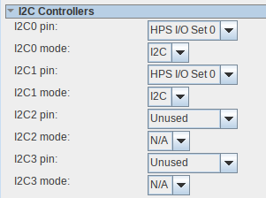

  • I enabled I2C1 in Platform Designer and selected HPS I/O Set 0: GPIO51 (SDA) and GPIO52 (SCL).

Quartus Platform Designer pin muxing:
