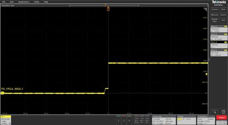

S10 Device Pin status
MSEL1 and MSEL2 are both external 4.7K resistor pull-downs, but measured as 1.8, look at s10 pcg doc, there is an internal 25K pull-up, according to my understanding should be between 1.8 and ...

    Hi Guo DeXin,
    Perhaps you will need to check your board signal integrity. In S10, pin connection guidelines, it is recommended to route in a way that no aggresor on this. More over, it is a reference resistor pin, is a input pin instead.
