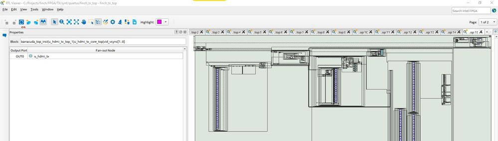

RTL Viewer -> how report a net/signal connectivity through hierarchies
Hi All,
How to report a net/signal connectivity through hierarchies?
How to report the drive/driven logic of the net/signal?
Thank you!
  • No, 'View -> Properties' only shows the properties of the selected object, it doesn't list the "sources and destinations".
    Under "Textual Report" I meant a list of the "sources and destinations" in the text format.
    • amildm's avatar
      amildm
      still waiting to somebody response.... how to generate a textual (text file) report attached find all the sources (drivers) and destinations (leaf logic) from the RTL viewer... Does Quartus support this feature?
      • ShengN_altera's avatar
        ShengN_altera
        Hi amildm,
        Can't find any related feature for that. Most likely the feature you mentioned above is not supported by Quartus yet.
        Sheng
  • yes, I'm getting a graphical representation of RTL with a sources and destinations of the given signal... But could I also get a textual report about all these source and destination signals? I'm about the back/forward tracing report for the given signal.
      Textual report? Not sure what you mean. Like a list of sources or destinations? View menu -> Properties.
    You can right-click any net or object in the RTL viewer and filter on the source, destination, or both of the selected item. Is that what you're looking for?
