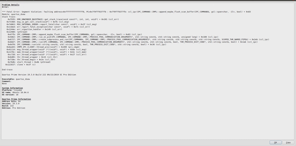

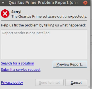

quartus Prime DSE crush
Design Space ExplorerII crush all times.

    Seem to me like a tool issue, is that okay for you to attach the design for me to replicate?
    or if cannot send full design, you may below step send compilation database without sending source design files
    If you want to keep your design files private for security reasons, you can use the Quartus® II database to send someone your full compilation results without sending your source design files. The Quartus II-generated database does not contain the source HDL code. Refer to the Related Solutions below for additional information on sending design netlists without sending source code.
