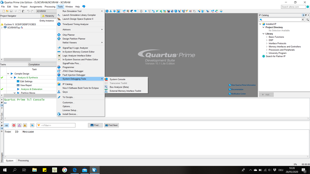

I have SoC Cyclone V device (5csxfc6d6f31c8es) on Terasic SoCkit board. I connected it using USB Blaster 2 with my computer. I am not able to access Transceiver Tool kit in Quartus Prime 15.1 Lite Edition. Why is that? How can I access it? All hardware setup is fine. Board is powered on. JTAG configuration is correct. My HDL Transceiver design is compiled correctly. How do I access transceiver toolkit?

As I understand it, you have some inquiries related to XCVR toolkit in Quartus Lite Edition. For your information, the XCVR Toolkit is not supported in Lite version. Sorry for the inconvenience. You may refer to the following for further details:
Please let me know if there is any concern. Thank you.
