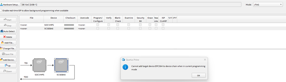

    You should have received a message that stated:
    "Cannot add target device EPCSXX to device chain when in current programming mode"
    when you added the .pof in JTAG mode. I just tried it with 11.1 with hotfix 0.12 installed.
    I would open a support with Altera on this.
    Also try it with a different .pof file and the same pof on a different machine if you have one available..

    What's the error announcement?
    Is the error coming up as soon as you attach the POF to the chain? or when you are attempting to program your device?
    Are you in Active Serial Mode, and not JTAG mode?
