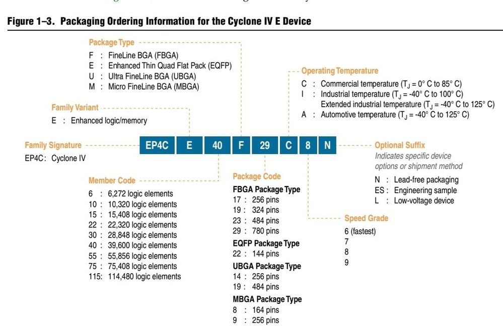

I have a DE2-115 Dev board and Quartus prime lite , When I open the new project wizard and get to the Family Device and Board settings page I tell it
Cyclone IV E
EP4CE115F29C7 which I assume is correct
but then it asks for
Package
Pin Count
Core Speed Grade
and I havent a clue which to choose , Can you advise please
Don
    EP4CE115F29C7 specifies unequivocally all parameters. If you select this type, all other fields can remain empty. To decode the type code, you can review Cyclone IV overview document.

    The other options are for filtering the matching parts list. You don't need to set them to anything if you've found the part you want to target.
  • FvM's avatar
    FvM
