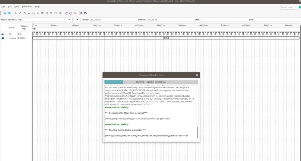

Problem with Quartus 19.1 under linux, When I Run a Functional Simulation in University Program VWF its never ends
See img
  • JVizc1's avatar
    JVizc1
    I looked the end time and it shows: 1 uS (I changed with 500nS but nothing happend)
    More information:
    Simulation options in Functional Simulation Settings: quartus_eda --gen_testbench --tool=modelsim_oem --format=verilog --write_settings_files=off test -c test --vector_source="/home/juanpavz/Dev/verilog/01/Waveform.vwf" --testbench_file="/home/juanpavz/Dev/verilog/01/simulation/qsim/Waveform.vwf.vt"
    when I start linux, I use terminal:
    ~$ intelFPGA_lite/19.1/quartus/bin/quartus
    /home/user/intelFPGA_lite/19.1/quartus/linux64/libstdc++.so.6: version `GLIBCXX_3.4.20' not found (required by /lib/x86_64-linux-gnu/libproxy.so.1)
    Failed to load module: /usr/lib/x86_64-linux-gnu/gio/modules/libgiolibproxy.so
    I can make analysis and synthesis (ctrl + k), view RTL and compile (ctrl + l). But I can't simulate with University Program VWF
    And , when I start the program it shows ​an error message: Error (14565): Can't connect to the Intel FPGA website to check for updates.

    You can set simulation end time,
    'Edit'->'Set End Time' from Waveform editor Menu bar.
    Please let me know if you have any different concern.
