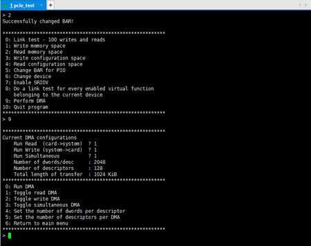

Hello, I am using quartus Pro 22.3 , device ( stratix10 1SX110HN2F43I2VG ) , IP core ( L-Tile and H-Tile Avalon Memory-mapped Intel FPGA IP for PCI Express 22.2.0 . When I use the DMA IP c...

Thanks for attaching the files.
Could you please try to run the DMA test using S10 Dev Kit following the FPGA Wiki? This checks if the environment you are using is compatible with the example design.
