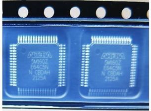

Need TR packing spec / datasheet for 5M160ZE64C5N.
If the part 5M160ZE64C5N has Tape and reel packing drawing spec / datasheet?
Pls share it that we want to know the Tape and Reel Dimensions and Pin 1 Quadrant Locations.

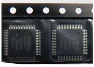

We had got two lots stock from the agency, but the Pin 1 Quadrant is different in the tape, thanks.
Pin 1 at Quadrant 2Pin 1 at Quadrant 1

    Noted on it, I will re-check with the authorize Distributor / Arrow for this re-packaging case, maybe it is their internal process but different packed for each lots, thanks.

    Hello ZanieZ,
    You may refer to this statement from our website :
    https://www.intel.com/content/www/us/en/docs/programmable/683255/current/trays-for-qfp-bga-fbga-and-lidless-fbga.html
    Refer to Thin Quad Flat Pack (TQFP)/ Plastic Enhanced Quad Flat Pack (EQFP) --> 64 (EQFP only)
    The body size is 7mm x 7mm.
    The number of unit that a tray can have is 250 unit.
    5M160ZE64C5N is packed in tray. If you receive it in reel or tape, and you received the part from our authorize distributor, most likely it has been repack due to some their internal process. You may contact our authorize Distributor Sales Support Team for clarification.
    For part orientation, you can refer to attachment "Part Orientation" as I have attached.
    Thank you!
