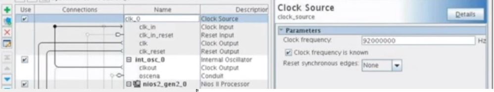

- PYtte
I found this on Youtube. He using a QSYS project to set the frequency it seems. Is this the way to choose frequency?

- PYtte
That is a solution when you know the frequency but from what I gather you implement the Internal Oscillator and get a frequency within the range of 55 to 115 MHz. There is no way for me to set a specific frequency. If I have a protocol that require precise timing I have to know the clock speed. I can´t have one board where the FPGA is running at 55 MHz and one where it is running at 116 MHz.
I will just implement a external clock on our PCB so I can make sure I have a specific frequency.
