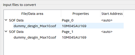

7 years agoMax10 Internal Dual Config - How to program only CFM0?
Hi. When creating a Max10 design with Internal Dual configuration scheme enabled, the "Convert Programming File" utility in Quartus forces you to populate both Page_0 and Page_1 with valid .sof file...

7 years agoHello Nikolay,
If you are using the Dual Configuration IP in the design then we must use the two sof file to convert into the single pof.
Actually i dont think it is the problem to fix it since as the design point of view you are opting for dual configiuration and tool looking for dual sof right ?
One another way is update single bitstream then need to use binary file (rpd) with on chip flash ip. Here is the application notes for reference
https://www.intel.com/content/dam/www/programmable/us/en/pdfs/literature/an/an741.pdf
Kindly let me know if you have any further question ?
