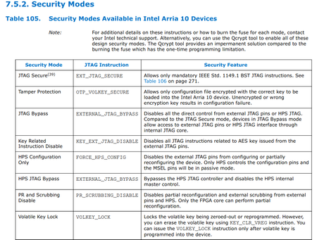

Hello , i would like to know the JTAG secure instructions such as OTP_VOLKEY_SECURE or EXT_JTAG_SECURE and how to program it to the Arria 10 .
YuanLi_S_Intel
6 years agoHi,
Tamper Protection security mode allows only encrypted bitstream to program the FPGA only, meanwhile for JTAG Security mode, it allows the access of JTAG to certain feature only.
You may refer to user guide below for the implementation:
https://www.intel.com/content/dam/www/programmable/us/en/pdfs/literature/an/an556.pdf
