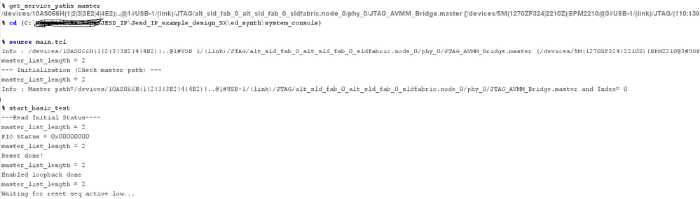

JESD Example design from Quartus - Arria 10 SX Devkit - Stuck at waiting for reset active low
I am trying out JESD IP example design to test in loopback mode, I generated design from Quartus prime pro 23.4
I am aware of the fact that only GX device is available in the dropdown list while generating the JESD IP example design. So, I generated the ED with board as NONE and later modified the pin constraints as per the SX device.
Design changes made wrt SX SOC devkit PRD edition :
1. Jesd IP configs are left at default settings except only refclk frequency changed to 100MHz from 125MHz in order to facilitate the clock from onboard SI clock chip.
2. global_rst_n pin is assigned to user push button - R5 pin - FPGAIO2_P net name.
3.SPI pins are assigned as Virtual pins.
4. sma_clk_out pin is set as virtual pin (This pin was just clock forwarded from device_clk in design)
5. Rest all pins are mapped accordingly to FMCB slot and loopback card is plugged into FMCB slot.
Design is going through till assembler without any errors, but facing issue while running through system console - Stuck at waiting for reset active low in system console.
Any inputs and help very much appreciated. Thanks
Sequence followed :
1.Board power ON -> Program SOF(100% succesfull) -> Launch system console -> Load sof
Modified -> main.tcl -> set master_index [expr {$master_list_length - 2}]
Rest of the steps I am following as per the user guide, I have attached the snap of the same.
