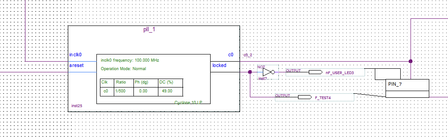

Hi there, I am working in a bring-up of a board that contains a Cyclone 10 LP FPGA. I am trying to use the 2x PLLs that the FPGA contains. I have generated from the 100MHz input clock, 2x 200KHz u...

2 years agoI can confirm that the input clokc is working fine, as I have used it to toggle LEDs using a counter module.
I am wondering if it is mandatory to have an isolated analog reference plane in the PCB as stated in doc an958:
In my design, we only have a ferrite to isolate VCC_PLL but we have not created an isolated GNDA, it is tied to digital ground.

2 years agoHope you have also bypass capacitors next to VCC_PLL and other supply pins.
Power integrity is hardly a problem unless your PCB has many fast switching outputs.
