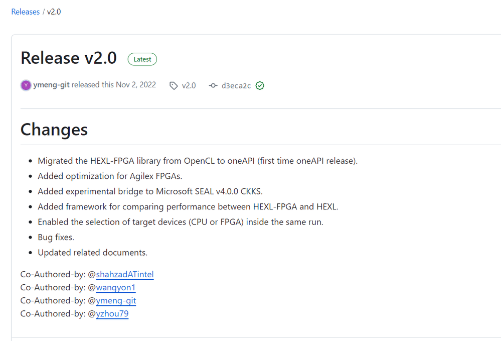

  • KianHinT_altera's avatar
    KianHinT_altera
    Hi Craig,
    Thanks for reaching out to Intel. I'm Kian and I'm assigned to look into this case.
    I'm checking with Yan Meng (the author for the github project) whether other cards is supported in the project. I saw the release notes mentioned about Agilex FPGAs but the readme still mentioned using D5005 . I'm also checking with our development team to ask about the ASIC mentioned in the link you provided.
    https://github.com/intel/hexl-fpga/releases/tag/v2.0
    Kian
