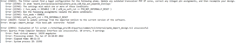

What modifications should I do on s10_ref (20.2) so that it is compiled successfully in intel quartus pro 20.4? When I try to compile it on intel quartus pro 20.4 without any modifications, it gives the following error. I am new to these concepts including PCIe, so I can not keep going. Can anybody help me on making necessary basic changes so that it is compiled successfully?
Error:

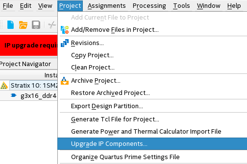

    1) To upgrade a design to newer version, open the Quartus project, go to Project --> Upgrade IP Components.

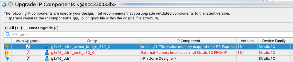

    2) Select the IP component that required upgrade --> click 'Upgrade in Editor', the IP component GUI will pop-up --> Generate HDL...
  • sstrell's avatar
