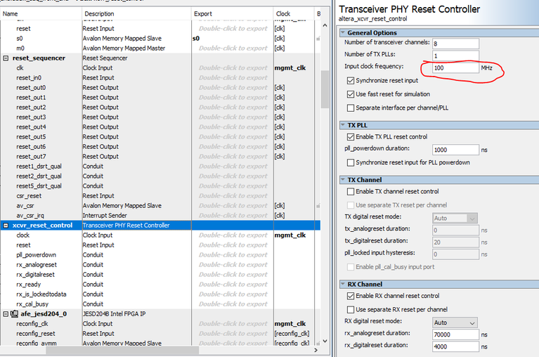

Hi Farabi
Rather than experimenting with cludge fixes I am focussing on the Platform Designer automatic generated:
(*altera_attribute = "-name SDC_STATEMENT \"if { [get_collection_size [get_pins -compatibility_mode -nowarn ~ALTERA_CLKUSR~~ibuf|o]] > 0 } { create_clock -name ~ALTERA_CLKUSR~ -period 8 [get_pins -compatibility_mode -nowarn ~ALTERA_CLKUSR~~ibuf|o] }\"" *)associated with the transceiver reset sequencer instance in the design -- doesn't seem to be an obvious IP parameter to tell the instance that CLKUSR is at 100MHz rather than 125MHz...
Transceiver PHY Reset Controller (parameters)Regards, Steve

- Steve-Mowbray-ENL5 months ago
Hi Aqid
Thanks -- all understood -- my purpose is to identify why timing analyser reports CLKUSR at 125MHz when our design requires 100MHz -- and if there is a method to indicate to Quartus/Platform-Designer what CLKUSR frequency actually is or failing that if the incorrect CLKUSR frequency reported is in fact unimportant and can be ignored (our project does seem to mostly run as expected but there are some quirks which could be related to transceiver operation)
Regards, Steve

Aqid- Steve-Mowbray-ENL5 months ago
Hi Aqid
That was my hoped for situation and seems to be confirmed by seemingly normal operations on target -- my concern was 125MHz was required whereas target has 100MHz leading to possible marginal behaviour...
