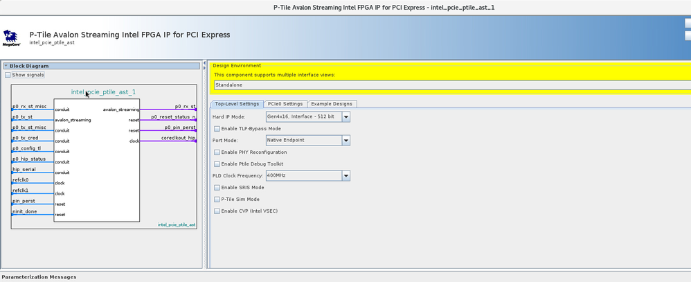

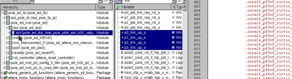

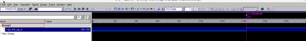

How to setting fast sim mode for P TILE PCIe simuation
use quartus 22.4 and device : Agilex AGFB027R25A2E3E, Generated example design, PCIe setting as following picture:
and running the vcs(P-2019.06-SP2-10) simualtion, link up need about 145us.
This is slowly for simulation, can you help me how to setting fast sim mode? Thanks so much.
