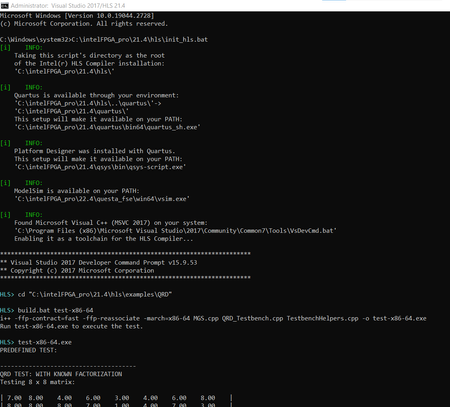

I am trying to run an Intel HLS Compiler design example on Windows by following the "Running an Intel® HLS Compiler Design Example (Windows)" guide.
I tried the "counter" and "QRD" examples ...
