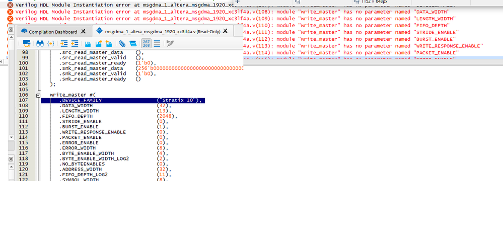

Im trying to follow the example in this page with 2 mSGDMAs: https://blog.reds.ch/?p=835
when i run synthesis I get the below error:

Hello, thanks for your response. This example seems like an overkill for what what I'm trying to accomplish. I tried the example from https://blog.reds.ch/?p=835 on the latest quartus pro and still get the same error with mSGDMA IP. Is there an example that demonstrates only uses mSGDMA similar to what's on that (https://blog.reds.ch/?p=835) website?
