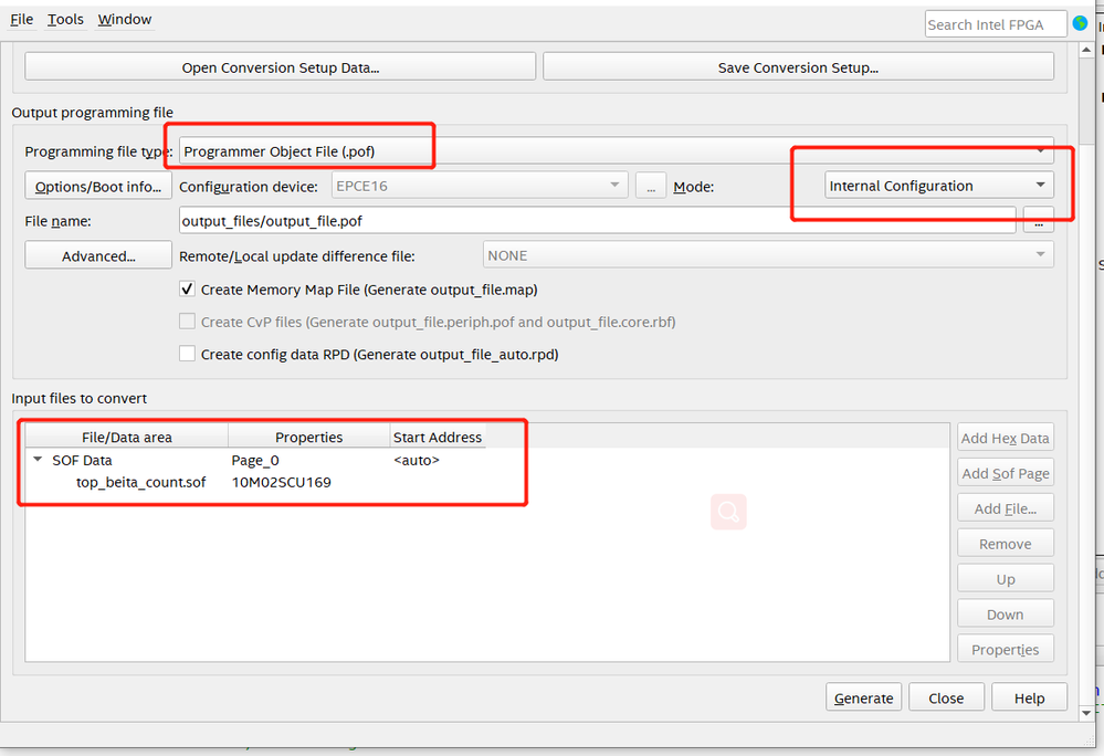

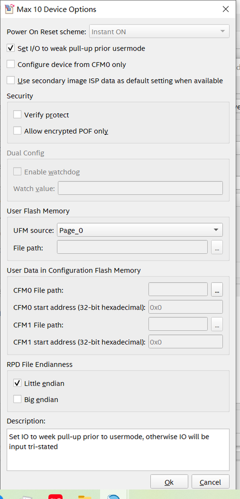

FPGA CPLD 10M02scu169 .pof download

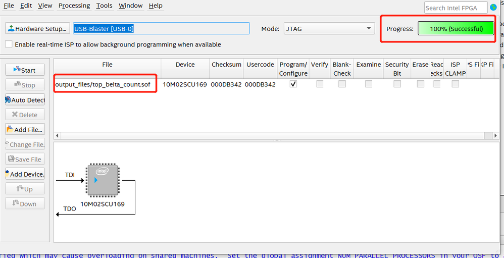

When I download the.sof file, the download succeeds and the program runs normally.

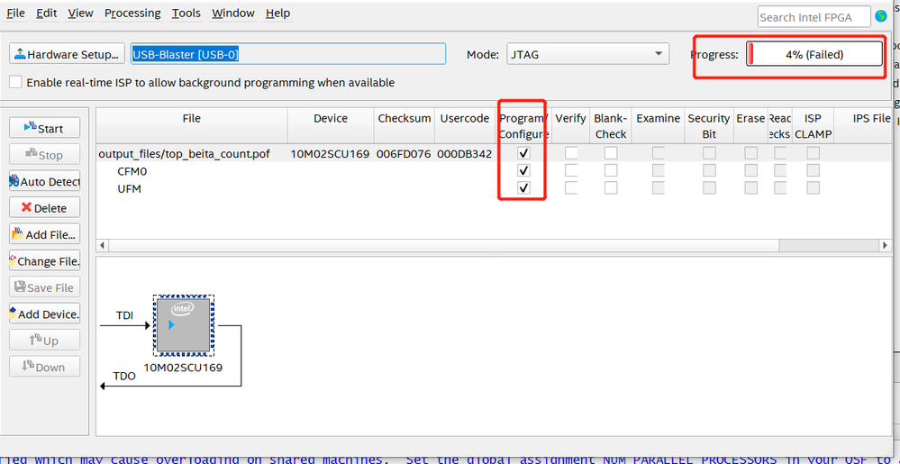

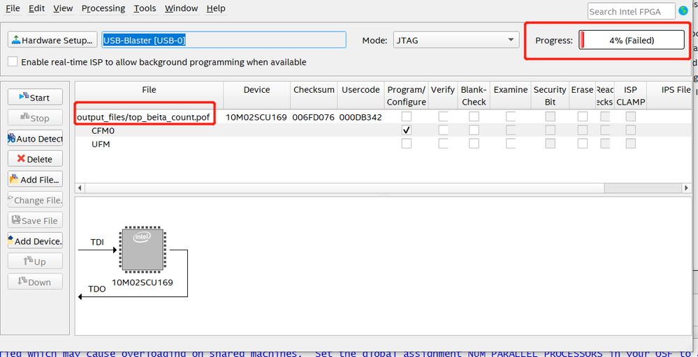

 But by converting.pof files, the download fails at 4%.
 so I download CFM0 or UFM ,failed。

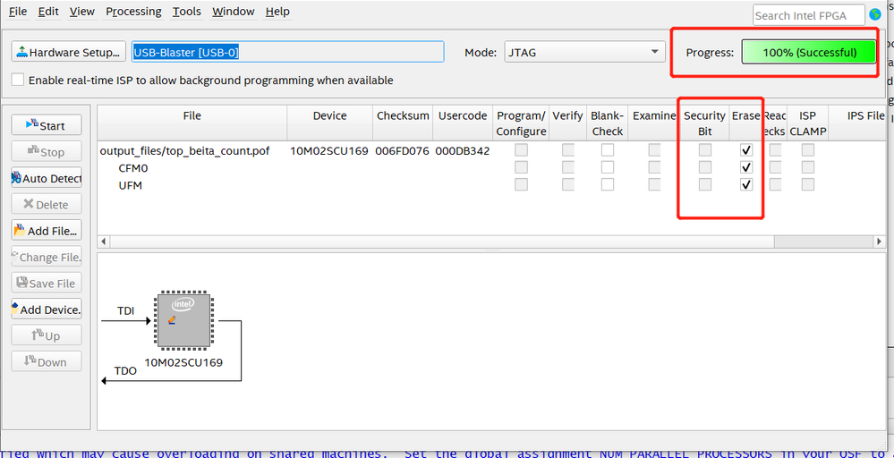

 When I use the erase function, it can be successful。

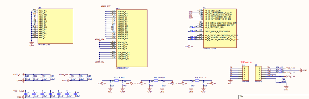

 I tried a lot of solutions, but they didn't work. I didn't know what was wrong. I was helpless. I hope you can help me solve this problem. Thank you.

    Please select: Quartus-> File -> Programming file Generator and select MAX 10 and try again~
