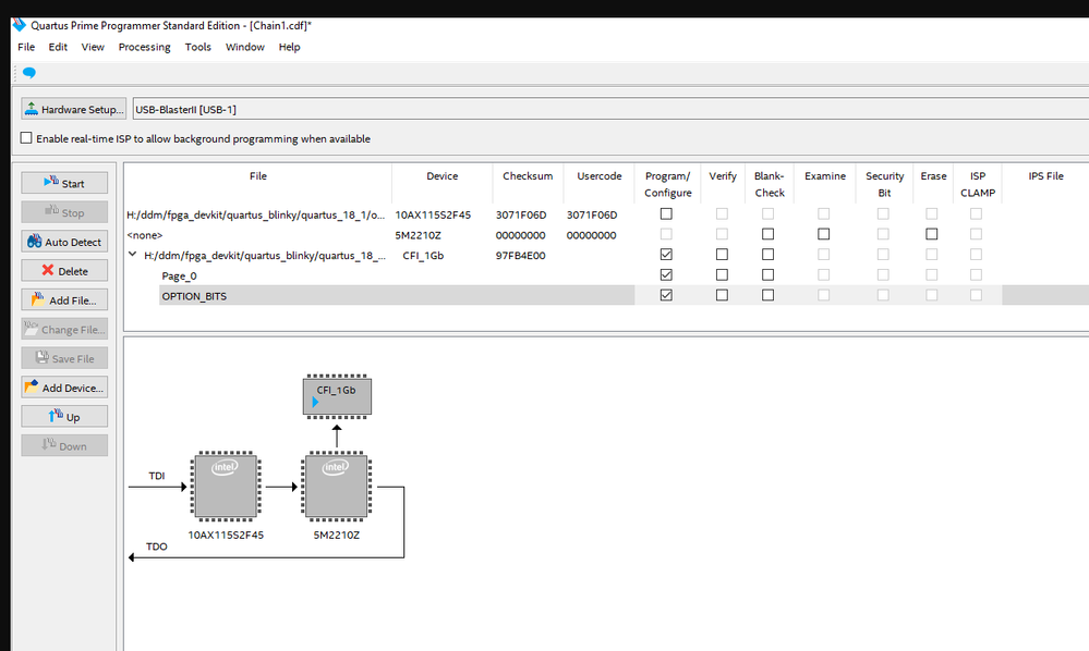

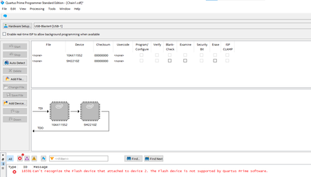

1) There was an option to add flash manually in the programmer, by clicking on the cpld (5M2210Z). I was able to add the CFI flash and it is showing up in the tool. image below. Is this also a correct way to add the flash?

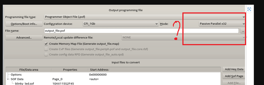

2) Let's say I would like to go with pof option using the above step, will it still be fine? If yes, then which mode should I use to generate the pof?. where should I find that information?

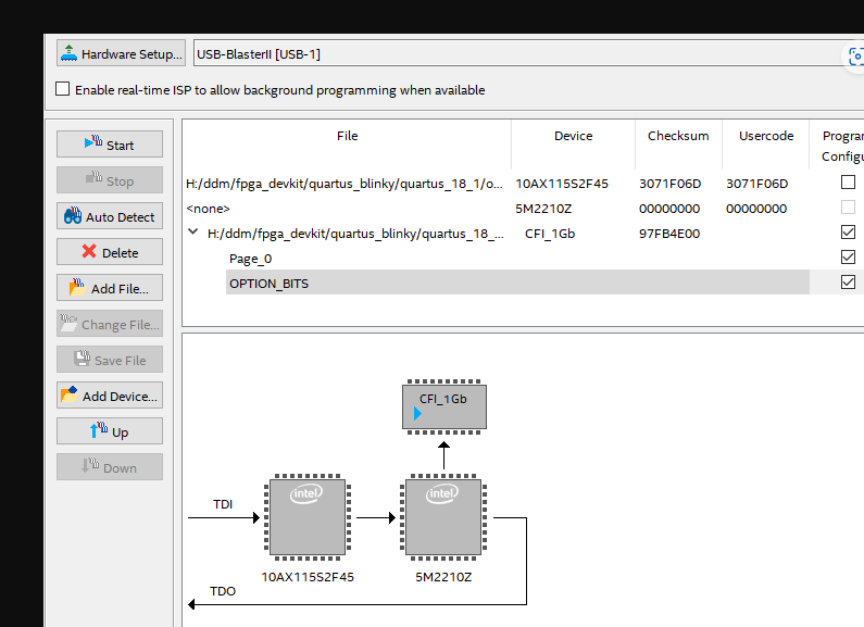

3) Once I generate the pof with correct mode and configuration, should I program the CFI flash and then also the pag_0 and option_bits as shown below?
