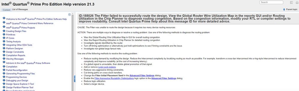

  • aesq's avatar
    aesq
    As I was facing a similar issue with my project,
    I took his example and played with the options, placement and so on.
    I found an option that makes the routing ok (I changed to my Cyclone V type).
    Intel should investigate why this option makes the routing failing.
    See picture showing the option, change it from ON to OFF.
    This was tested with Quartus 21.1.1 std.
