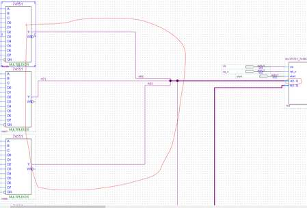

Hello everyone! Recently, I encountered an issue while designing FPGA circuits using Verilog and Quartus, and I would like to seek your advice. I'm trying to connect a multi-bit port, but during com...

The bus wire needs to be assigned the name as well (Right-click -> Properties) in your case is A[3..0].
You can leave them unconnected also (check image attached) because they will be connected automatically after compilation, but just make sure those wire naming are matching.
