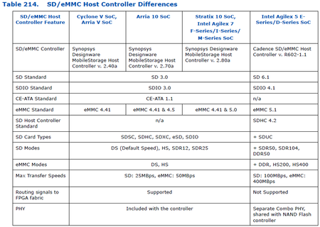

Good day, Can I use an eMMC 5.0 device with the Agilex 5 FPGA? I will connect the eMMC to the HPS. The guide states that eMMC 5.1 must be used, but is it backwards compatible? Kind regards, ...

Yes, Agilex-5 eMMC 5.1 is backward compatible with older standards.
