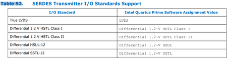

Does Cyclone 10 GX general-purpose IO SERDES support diff SSTL-12 output?

The maximum achievable I/O frequency is different for each I/O standard and is depends on design and system specific factors. Ensure proper timing closure in your design and perform HSPICE/IBIS simulations based on your specific design and system setup to determine the maximum achievable frequency in your system.

1) The IP is for LVDS only. The name itself is LVDS SERDES Intel FPGA IP. So it supports only LVDS.
2) The restriction arises because it mentions that it requires true differential I/O standard. Only LVDS support that
3) Section 5.6.3 does not say about the dedicated circuitry.
Thank you.

Thank you for your reply.
As you said, the LVDS SERDES IP supports only LVDS. How does Cyclone 10 GX general-purpose support 1.434 Gbps differential SSTL-12 (https://community.intel.com/t5/Programmable-Devices/Does-Cyclone-10-GX-general-purpose-support-1-434-Gbps/m-p/1287593)? I need to transmit 1.434 Gbps data in diff SSTL-12. I cannot use LVDS because the common mode voltage of LVDS is not compatible with the data receiver.
