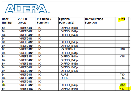

2 years ago[Documentation Error] Cyclone 4 Device Pin Outs, Ball U17/V17, F324 package, PDF
Hello, Request for confirmation of correct usage of U17 and V17 on F324 package for Cyclone EP4CE30 part. I was reviewing the Cyclone 4 device pinout for EP4CE30F19A7N part. PDF documentati...
- 2 years ago
Sorry for the delay. For your information, you should follow the excel file for PIN U17 and V17 for F324 Package which is GND. As for now we will fix the PDF file.
Hope that helps.
