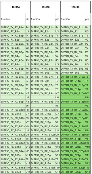

I have designed a board with the FPGA 10M04SAU324, and I want it to also be compatible with the 10M08SAU324 and 10M16SAU324. I am using bank 3 for the TRUE LVDS signals. I have noticed that all three...
