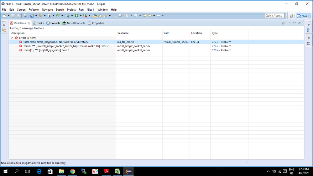

"Description Resource Path Location Type fatal error: altera_msgdma.h: No such file or directory". This is the error I'm getting if I run Nios II Simple Socket Server (16.0) in the Intel Quartus version 17.1
I have downloaded the .par file from the link (https://fpgacloud.intel.com/devstore/platform/16.0.0/Standard/nios-ii-simple-socket-server-ethernet-example-for-cvgt/) and followed the steps to create software project as given in the pdf https://www.altera.com/en_US/pdfs/literature/tt/tt_nios2_tcpip.pdf .
The quartus version that I've used is 17.1.

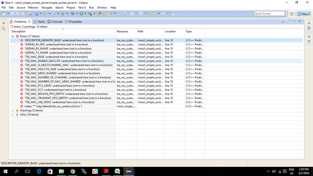

If I use Quartus version 16.0, I am getting the different errors related to "DESCRIPTOR_MEMORY_BASE" undeclared here (not in a function).
I am attaching the screenshots of the errors related to both versions i.e. 16.0 and 17.1.

Could you try to replace the SGDMA controllers with Modular Scatter-Gather DMA ip in .qsys file?
- MEIYAN_L_Intel
This issue seems like due to SGDMA to MSGDMA migration. Intel is recommending the MSGDMA. Please check this document:
https://www.altera.com/en_US/pdfs/literature/ug/ug_embedded_ip.pdf (page 297) First line. This change applied also to the TSE, the drivers expect to work with msgdma not sgdma.
Could you try to change from the sgdma to msgdma in your .qsys file?

Hello MeiYanL!! By looking at the MAX 10 solution, I've found that the sgdma is being used there in its version 17.1. Can you please elaborate what changes are you suggesting to make by going from the sgdma to msgdma in the .qsys file?
- APaga1
I will try changing from the sgdma to msgdma in the .qsys file. The example for Nios II Simple Socket Server Ethernet in Quartus Prime Standard v17.1.1 is for the MAX 10 board. My exploration is limited to Cyclone GT V. Thank you for your reply.
