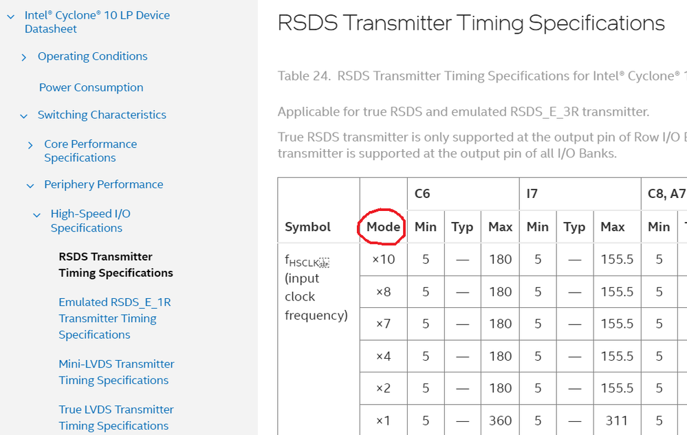

Definition of 'mode' in Cyclone10LP datasheet
In the section ‘transmitter timing spec’, what is the meaning of mode?

    Yes, after checking, I feel it more appropriate to say it refers to number of bits used by SERDES.

    "mode" refers to the number of bits used by the serdes.

    Hello Spike,
    Thank you for reaching out Intel FPGA Community.
    From what I understand, the mode here means the channel used, so the datasheet differentiates the information according on the channel used in the design.
