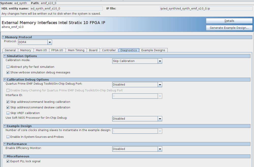

3. Disable address/command calibration step one by one shown as below.

3) The example design already disabled that setting.

To disable/skip address/command calibration step is to enable the highlight setting. Pls make sure you follow it. If all the 3 actions you are implement, please let me know the result.

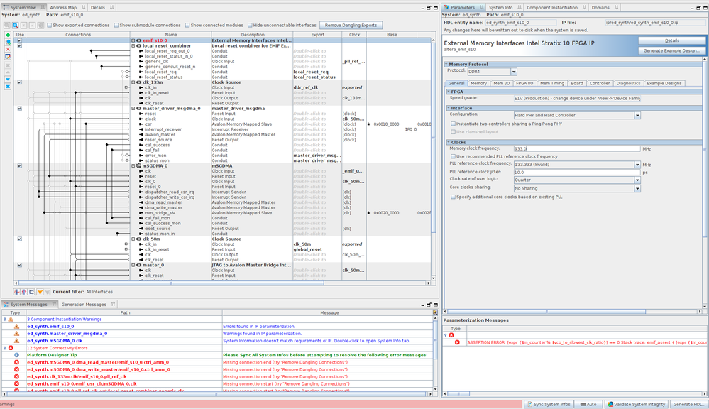

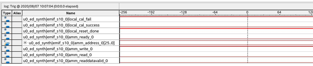

Lowering the frequency to 933 or 933.3333 caused error as shown below
I also made the test with
- Skip address/command leveling
- Skip address/command leveling & deskew
None of them works.
