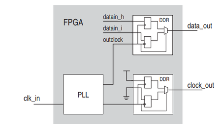

Hi Intel Community,
I've got problems with the timing of a RGMII Interface.
In my design the FPGA imitates an Ethernet PHY. So the FPGA has to delay the RX and TX clock by 90 degree internally....

4 years agoEdit: Sorry, I should have read more thoroughly--you're referencing timing violations, not a broken interface.
Paul
I'm not sure if this relates to your issue, but I got recently got burned trying to apply that Application Note by the DDIO IP's port naming. It turned out my forwarded clock was inadvertently flipped 180 degrees, breaking my source synchronous interface:
The documentation for that IP is not my favorite.
