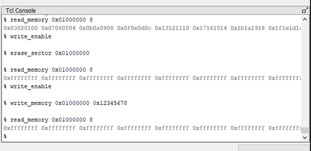

7 years agoCyclone V: Can`t write data to MT25QL256 user space with ASMII II
Hi. I have custom board with Cyclon V and MT25QL256 . Refer to "ASMI Parallel II Intel® FPGA IP Core User Guide", I can read, erase memory via SystemConsole. But "write_memory" command don`t work. ...
Lecsano
7 years agoI found solution! Refer to "Quad-Serial Configuration (EPCQ) Devices Datasheet " from Intel, operation code is 0x12 for Extended Quad Input Fast Write Bytes Command. But for MT25QL256 this code is 0x38. So I changed it in "altera_asmi2_xip_controler.sv" and all works)
