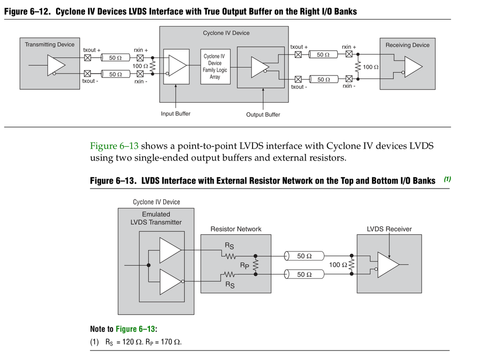

On the true LVDS drivers do I need to set any driver parameters, particularly series termination?

  • FvM's avatar
    There are no parameters for driver termination. Just set LVDS IO-standard.
  • NazrulNaim_Intel's avatar
    NazrulNaim_Intel
    To answer your question. Yes, you need to set the driver parameter which is the series termination.
    Hope that answers your question.
