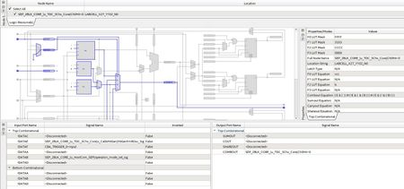

- MinzhiWang2 years ago
Hello Richard,
Yes, I know that Cyclone 10 GX doesn't support ECOs. I posted this thread to ask if there any other methods, for example setting in source codes to complet my purpose.
I will post one simple project here. Actually, I just want to know several key LUTs connection changing method.
