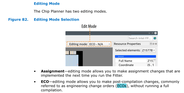

1. I posted one thread for ECO issue of C10GX devices, https://community.intel.com/t5/Intel-Quartus-Prime-Software/Does-QPP-Quartus-Prime-Pro-hide-or-disable-engineering-change/m-p/1593364#M82725
I thought I have got the answer, C10GX doesn't support ECO any more, as follow image shows. The ECO function is disabled for C10GX devcies.
If you have oppsite answer, please let me know and prove it for me. I'll appreciate for this.
2. Why do i need to do this? I just want to use ECO funtion on C10GX deives. It's that simple.

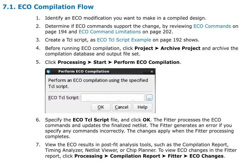

I also give the "7.1. ECO Compliation Flow" section's detail as following image:

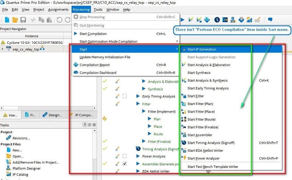

Then I went to my project, and didn't find the item "Perform ECO Compilation" from Start menu as above image. Which shows as following image, this proves again that Cyclone 10 GX doesn't support ECO fucntion.
BTW, my purpose to use ECOs, just as you said, to change LUT connections. We only want to edit several specitial LUTs connection. They are the most important nodes in our design. We want to keep them uniform. That's why we try to edit or change those LUTs connections. You know, the LUTs connections can vary in different compliation. You can't keep them uniform just with different compilations. Only ECOs can approach this object.
