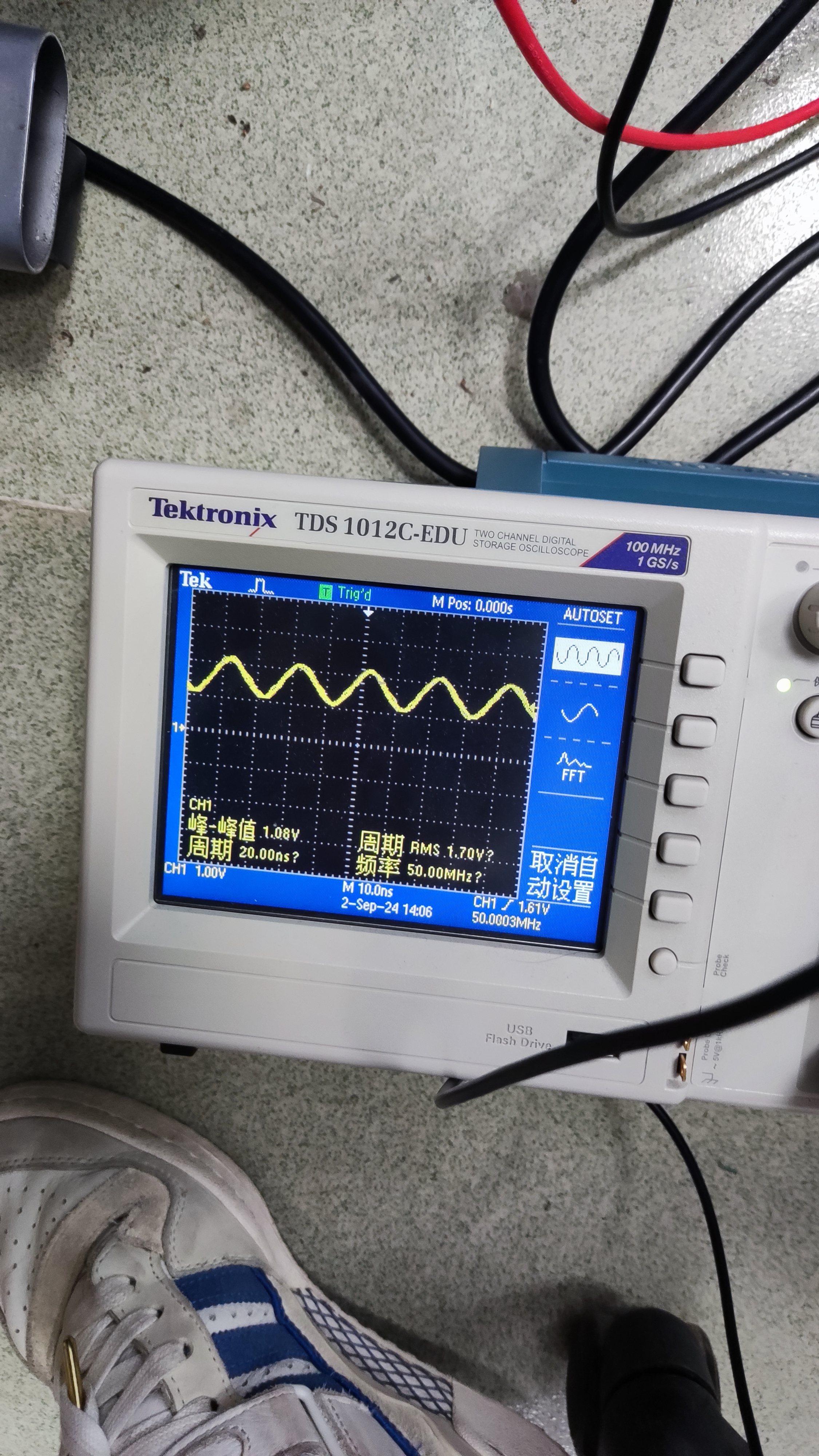

I am using the chip EP4CE15M8I7N, andi tried to use PLL in ip-core, but the frequency of the clock output is wrong. The frequency of the input clock is 50MHz, and what the frequency of the output i hope is 5MHz. But the fact is the output frequency is not right.
The clock from osc to supply into the chip is 50MHz which have been verified, but the frequency of clock output from pll just only range from 30KHz to 50KHz.

  • Hi,
    low frequency PLL output is usually indicating missing input clock. I suspect wrong pin assignment or similar.
    Frank

      Thanks again for your reply, I found that our hard design have some problem about power supply of the pin of PLL, we are going to solve it, Thanks!
