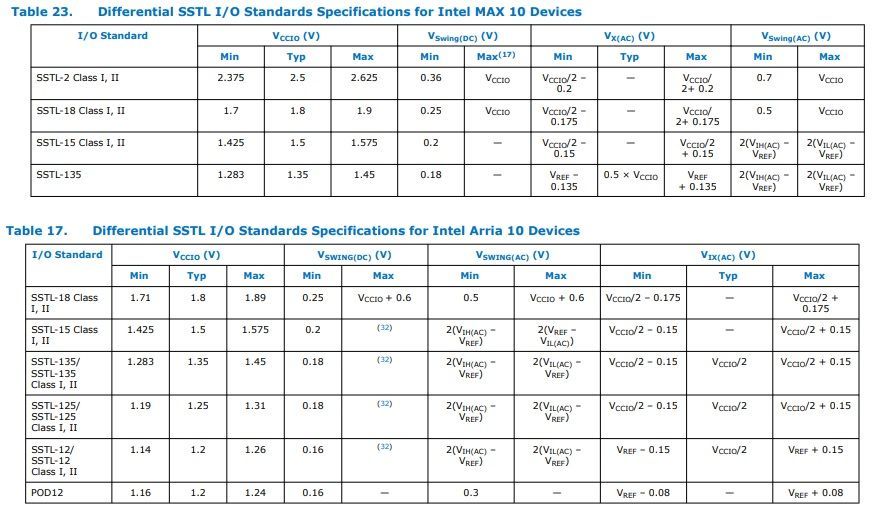

6 years agoCan the Max 10 and arria 10 support SSTL1V8 bidirectional differential comms ?
The Max 10 is 10M50DAF484I7G
Hi @RFoy0
Yes, Both device supports bidirectional differential SSTL-18 Class I, II(Refer below image).
For more details refer Device Handbooks
