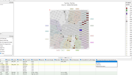

Hello : I'm using stratix 10-1SX110HN2F4312VG, When I tried to constrain the termination resistor, I found that there was no option for it. I opened the project of A10 and found that the A10 ser...
- 2 years agoI have resolved this issue. Constraints should be applied in the assignment editor, assignment name is input termination
